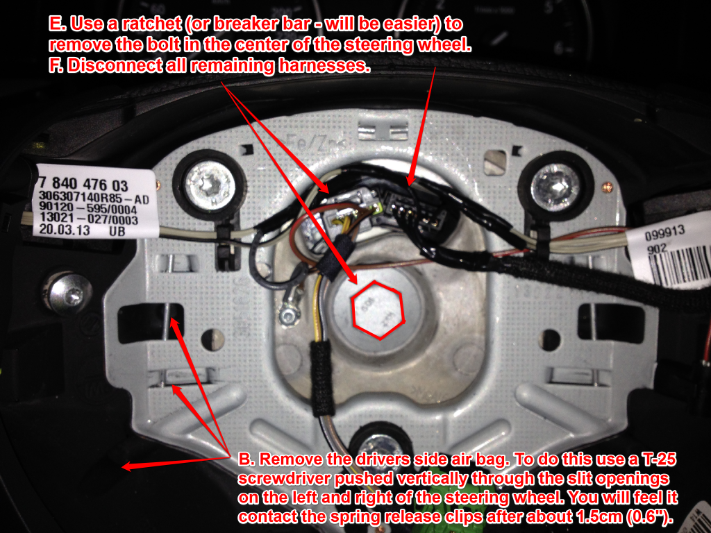

B. Remove the drivers side air bag. To do this use a T-25 screwdriver pushed vertically through the slit openings on the left and right of the steering wheel. You will feel it contact the spring release clips after about 1.5cm (0.6"). Repeat for the other side, the airbag can be removed by gently pulling on the top. Do not pull very far as the air bag wiring is still attached.
C. Remove the two harnesses attached to the back of the airbag. Use a flathead screwdriver to gently pry the back of the clips up, and out.
D. Place the airbag in a safe, dry location out of the way.
E. Use a ratchet (or breaker bar - will be easier) to remove the bolt in the center of the steering wheel.
F. Disconnect all remaining harnesses.
F. Gently pull the steering wheel towards you, it will slide off.

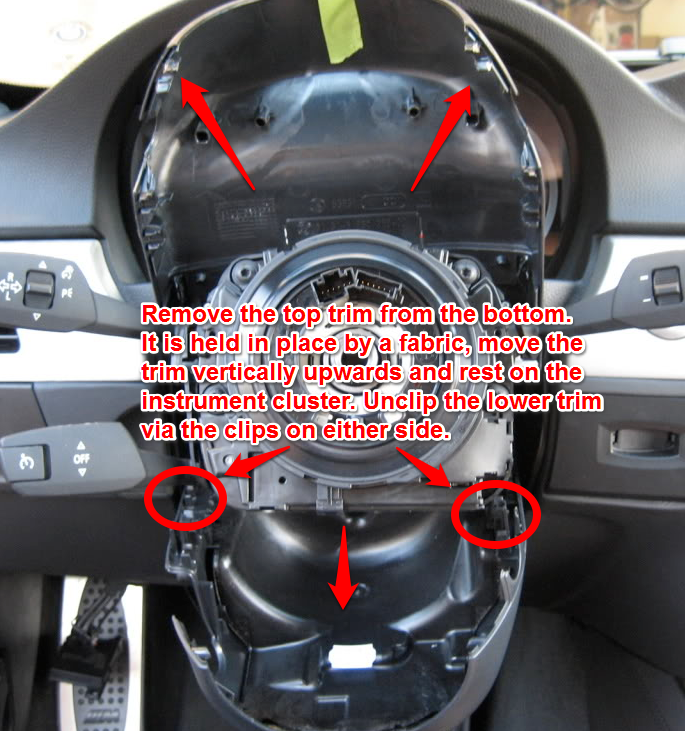

A. Remove the steering column trim.
Use the plastic panel remover tools. Gently pull up on the top front of the trim while inserting the smallest panel remover in between the top and bottom trim pieces. Pry the tool up/down to loosen the trim. You will hear a popping noise as the trim separates, it is held in place via friction clips. Repeat on the other side & remove the top trim from the bottom. It is held in place by a fabric, move the trim vertically upwards and rest on the instrument cluster. Unclip the lower trim via the clips on either side. Place the lower trim out of harms way where it won't be damaged.

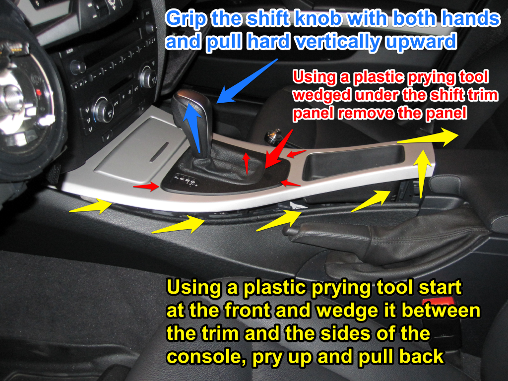

B. Remove the center Console Trim
Grip the shift knob with both hands - brace yourself and pull hard vertically upward. Be prepared for the force to release so you don't smoke the roof of your car. Place the shift knob out of the way.
Using a plastic prying tool wedged under the shift trim panel remove the panel from the center console, move and store out of the way.
Open the center console arm rest storage. Using a plastic prying tool start at the front and wedge it between the trim and the sides of the console, pry up to release the friction clips. Repeat for the remainder of the panel & remove by lifting the rear up and sliding back, the front is wedged slightly. Remove all harnesses.

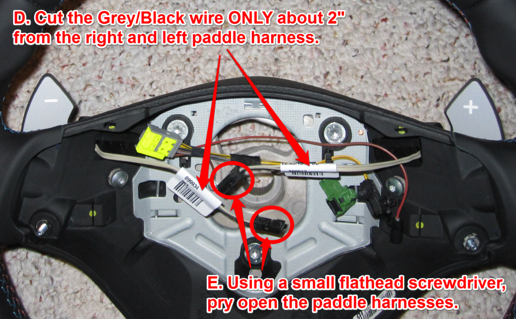

D. Cut the Grey/Black wire ONLY about 2" from the right and left paddle harness. (this is so you have room to re-solder it back on should you need to, or if a mistake was made.) Note: On the image below I shortened the wire on the right harness so it would fit a little cleaner, this is NOT necessary, I was just being OCD.
E. Using a small flathead screwdriver, pry open the paddle harnesses. The harness should be built with one side hinged, remove both pins and keep the grey/black wire handy. You can always repair the wiring and re-pin the harness if you want to sell it later.

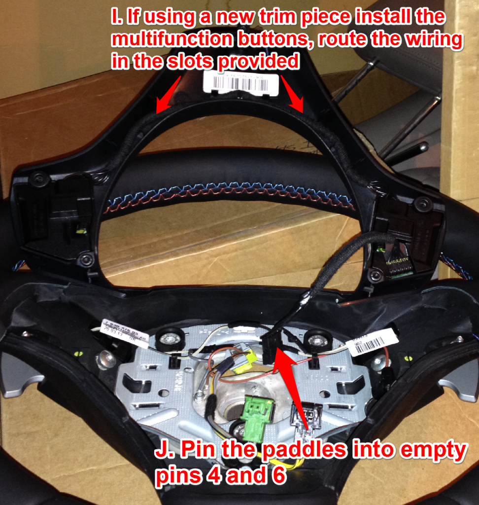

I. If using a new trim piece install the multifunction buttons, route the wiring in the slots provided at the lower end of the steering wheel

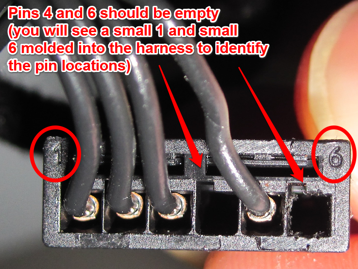

J. Pin the paddles into empty pins 4 and 6. Right paddle goes to pin 6, left to pin 4. You may need to open the harness using a flathead screwdriver like we did for the paddle shifters. This will certainly make it easier

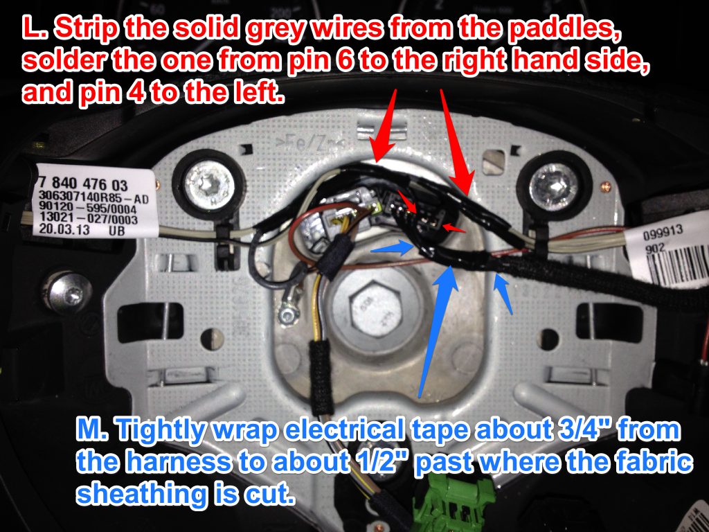

I. Carefully cut the fabric sheathing with an x-acto knife on the multifunction button harness, be careful not to cut the wires inside. Once through, use wire snips to cut the removed fabric off without cutting the wires - you will not be able to reuse this easily, taping will take less time and less hassle.
J. locate pins 4 and 6, cut the wires about 1.5" from the harness.
K. Bend the cut wires away, strip the wires leading the the harness. Place heat shrink over the other ends (multifunction button side) so 50% is on the wire and 50% is not, use a lighter to heat the heatshrink. Bend the portion not covering the wire back and wrap electrical tape around it - this will prevent this wire from contacting anything in the steering wheel. You don't know what it does without extensive research, for all we know it could potentially blow a fuse, damage a system, or possibly set off the airbag inadvertently (if it has a live 12v charge and contacts the airbag leads somehow - very very unlikely but possible) Just follow these steps to make sure its fully isolated, then you won't have to worry.
L. Strip the solid grey wires from the paddles, solder the one from pin 6 to the right hand side, and pin 4 to the left.
M. Tightly wrap electrical tape about 3/4" from the harness to about 1/2" past where the fabric sheathing is cut.
N. Route the wiring in the slots provided at the lower end of the steering wheel (see image above in factory sport wheel instructions)

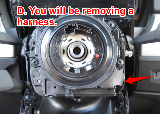

D. Go to the steering column, on the right hand side you will be removing a harness. There should be two, you will remove the one on the left when seated in the driving position.

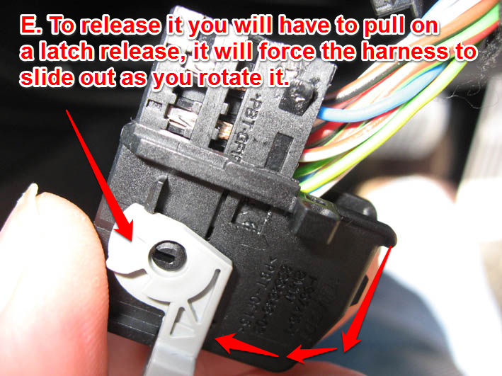

E. To release it you will have to pull on a latch release, it will force the harness to slide out as you rotate it.
F. In this harness you will either have a yellow and a yellow/black wire in pins 2 and 4. Alternatively they might be empty.

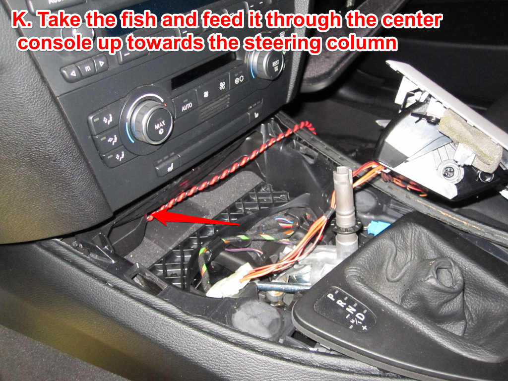

K. Take the fish and feed it through the center console up towards the steering column, it should be a fairly open path with no obstructions. When you see it appear pull about 8" through - make sure you still have one end sticking out at the cluster
L. Take the braided wire and tape the end which will go to the shifter tightly to the end of the fish sticking out at the cluster. Then pull the fish from the center console through - it will pull the wire down. Once out remove the tape and remove the fish from the vehicle.

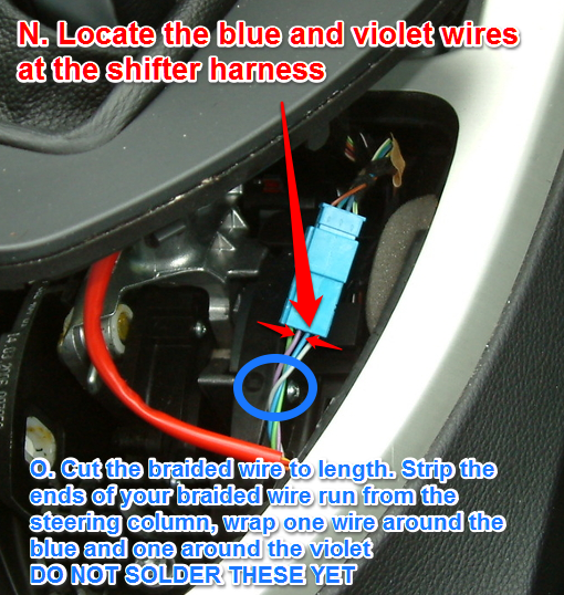

N. Locate the blue and violet wires (two center wires) at the shifter harness. VERY carefully shave the sheathing off with a knife.
O. Cut the braided wire to length leaving enough to comfortably reach the wires. Strip the ends of your braided wire run from the steering column, wrap one wire around the blue and one around the violet, DO NOT SOLDER THESE YET

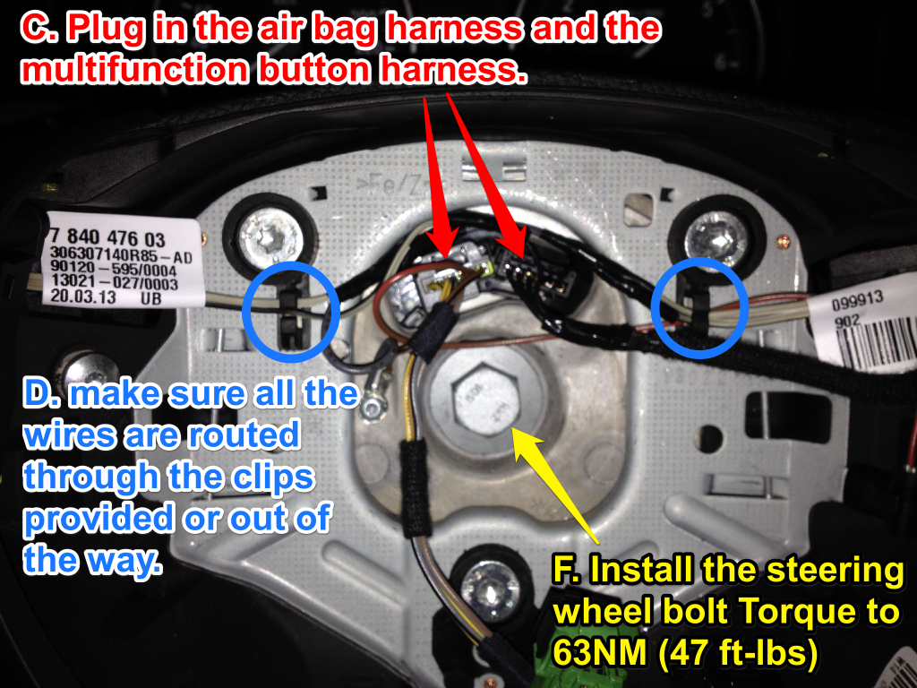

B. Place the steering wheel on the column - there is a notch in the wheel so it only goes on one way.
C. Plug in the air bag harness and the multifunction button harness.
D. make sure all the wires are routed through the clips provided or out of the way.
E. Do a final check on all connections, make sure they are properly connected and routed properly
F. Install the steering wheel bolt - Torque to 63NM (47 ft-lbs)

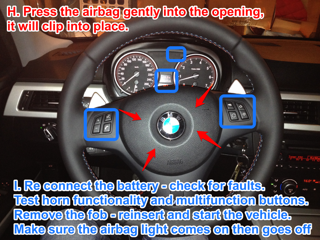

G. Reconnect the airbag, make sure the release clips are pressed down.
H. Press the airbag gently into the opening, it will clip into place.
I. Re connect the battery - check for faults. If check = ok continue. Test horn functionality and multifunction buttons. Remove the fob, open the door then close it. Insert fob and start the vehicle, observe the airbag light in the top right of the HUD and make sure it comes on and then goes off - this is the system checking the SRS functionality and indicates normal operation. If cheque does not = ok, or airbag light does not come on or does not go off investigate before continuing.

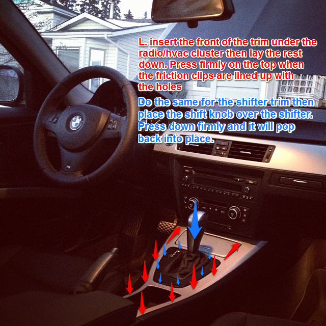

L. Re assemble the interior, starting with the center console trim. Re-connect all harnesses and insert the front of the trim under the radio/hvac cluster then lay the rest down. Press firmly on the top when the friction clips are lined up with the holes - it will snap into place. Do the same for the shifter trim then place the shift knob over the shifter. Press down firmly and it will pop back into place.
